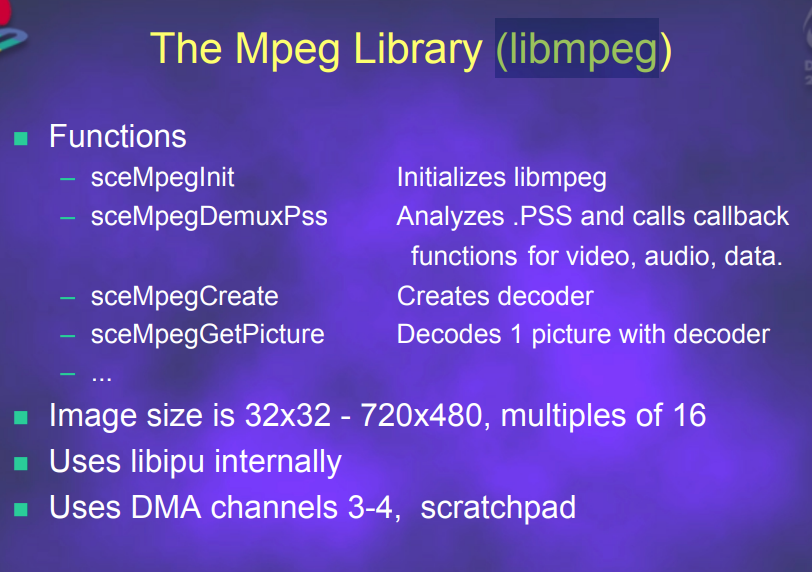

PS2STR does work fine, but SCE's SDK doesn't include its source code, so we don't know exactly how it works under the hood.
However, the PS2 SDK does contain playback code for the PSS video format. You can search for "libmpeg" within the SDK; some of the function names clearly indicate they are for handling PSS. You might be able to reverse-engineer the process to figure out the specific encoding details of the PSS format.
